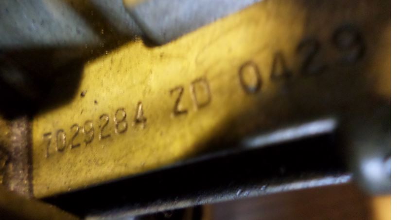

LS350 Offline
#17 Posted : Wednesday, 24 April 2019 7:13:56 AM(UTC)
LS350
Joined: 13/08/2016(UTC)
Posts: 46
Thanks: 11 times
HK1837 Online
#18 Posted : Wednesday, 24 April 2019 4:25:02 PM(UTC)
Posts: 14,813
Was thanked: 532 time(s) in 507 post(s)
Originally Posted by: LS350 Go to Quoted Post
That is a very different stamping to any I have seen of the same era.
