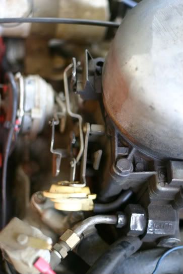

Hello people.
Changed the air filter on my gas hat as she was having trouble breathing, then I noticed this plastic vacuum actuator that looked a bit broken, so I touched it... *SPRONG!* Bugger. The inlet manifold vacuum seems to keep it together when the engines running though. Anyone know what it is and where I can get another? Here's a pic:

Havent used a QUAD in a while now, BUT, if its that white thing that goes to the QUADDIE base it is part of the linkage gear for the butterfly on the big rear secondaries on a QUAD. It lets the big flaps at the back OPEN. WIth that buggered the BIG FLAP w

Thats the one. The butterfly seems to open OK, as I said the manifold vacuum seems to be holding the whole thing together. Its probably sucking air though. Im reasonably new to Melbourne, so Im still trying to find decent places to get bits from. If anyon

That's the one. The butterfly seems to open OK, as I said the manifold vacuum seems to be holding the whole thing together. It's probably sucking air though. I'm reasonably new to Melbourne, so I'm still trying to find decent places to get bits from. If a

Hi the Blue Light.
That little diaphragm has 2 functions. It is the secondary control diaphragm & also the auto choke pull-off.
Any carby specialist will have them, or you can get it at Repco or Bursons etc. The Fuelmiser part number is RT601CP from
