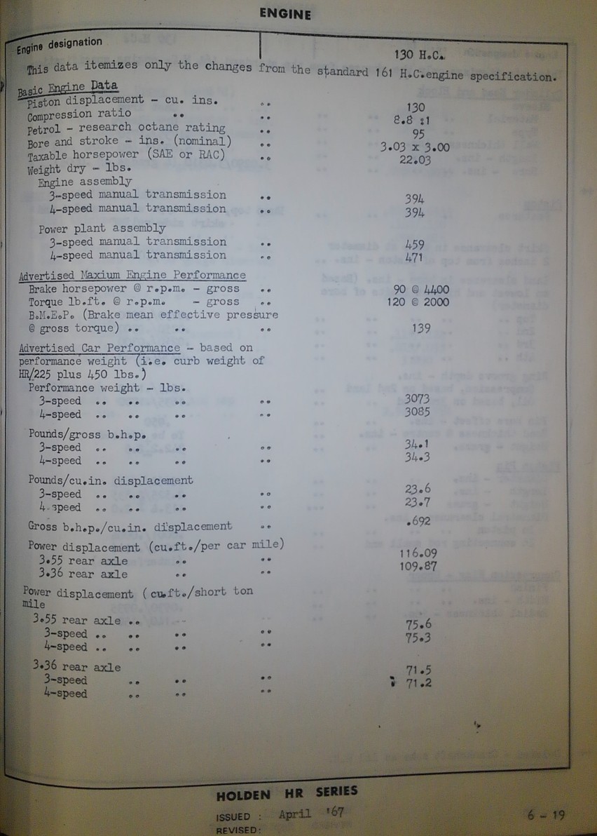

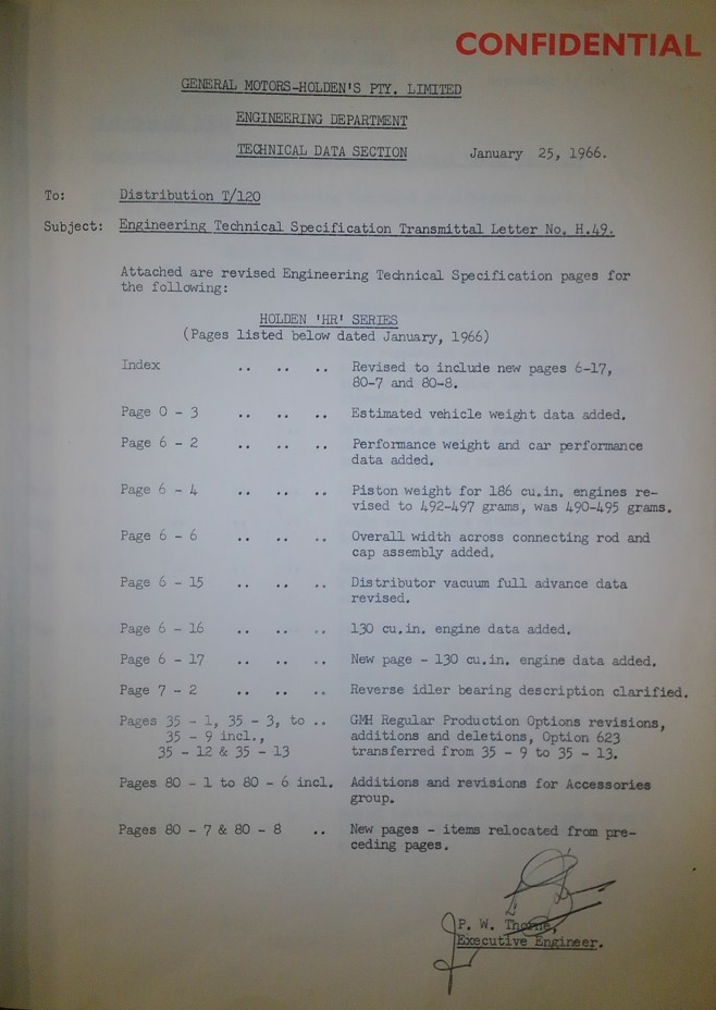

Yes Terry, option 636. Only available as RHD, Export only and manual only. Only available on 215, 225, 219 and 229. There is nothing in the HR Eng Tech Specs that spells out its engine number prefix.
Here is where it was added to the Eng Tech Specs:
There was no need to give RPO codes for stuff that was standard, I know its an extreme example but there was no RPO code as far as I know for front drum brakes - you couldn't order it.

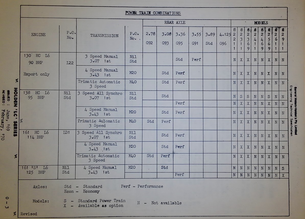

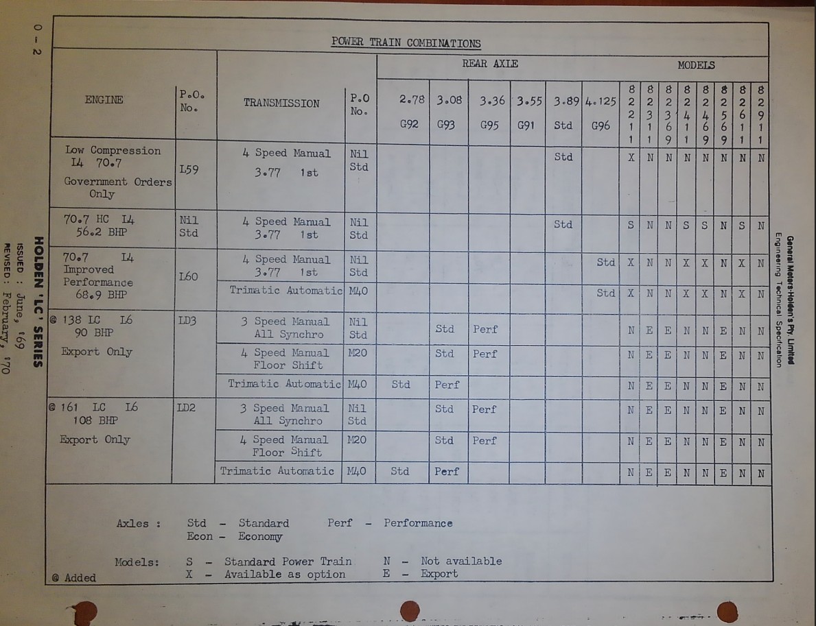

Here is question 2 answer. Again pictures show all.
As per the question, GMH already had L20, L21, L22 and L23.
For LC they added the 138HC but it didn't get an RPO code (sheet 2 below). But they needed codes for the following as they were optional on LC:
161HC and 138LC.
So they used LD1, LD2 and LD3 (not sure why LDx but that is what it was). They used the HK's L22 for the 130HC, but for some odd reason they used LD2 for the 161LC where it already had L21. LD1 continued for the 161HC and into 173HC ongoing, and LD2 continued into LJ to UC for 173LC but L21 was used for 161LC and later 173LC for HT-HZ/VB. That LD2/L21 in an anomaly.
What is also interesting is GMH used LD6 for the 138HC as it replaced the 130 in export HJ and it needed a code being an optional engine. They also used LD4 for the 250ci 6cyl engine in South African Holden and LD9 for the 250HO engine.
Terry, there is another code for you. Not sure if it would have been QB or JB for the 138 (2.25L in HJ) - we need to find one overseas. In theory it would be JB as it was first used in HJ, whereas the LJ version continued with CB as it just carried over.
Smitty, I just remembered LH used L15 and L16 codes for the two different Opel 1900 engines. Not sure why the XT5 3.3 got stuck down with them.
