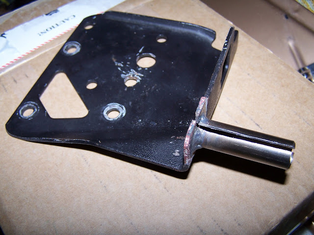

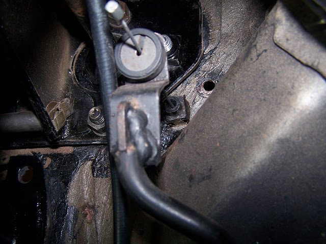

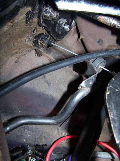

#3 Posted : Thursday, 11 February 2010 7:56:54 AM(UTC)
Hi Pete
You getting closer??
Heres some pictures of my setup.
I cant tell you what cable it is, but Id bet its Commodore V8 - VN-VS. Matbe mick can confirm this.
It looks like they modified the pedal linkage inside the car, but it had way too much slop and wouldnt open the throttle body completely.
I had a local guy add some tube to the throttle cable support bracket around 40mm long and cut a slot for the cable to go through.
Bought the peddle up from the floor and the throttle body opens fully now.
Let me know if you need any more photos or dimensions.
