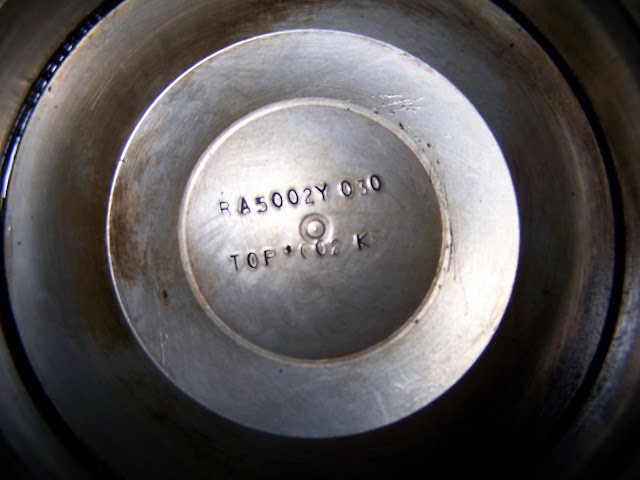

Morning team
Can anyone identify this piston for me from the Gs engine?
I assume it's 30 thou over, but can anyone tell me anything else about it??
#2 Posted : Wednesday, 3 February 2010 6:51:33 PM(UTC)
I think that is a Sealed Power or Speed Pro number. Ill see what I can find.
#3 Posted : Wednesday, 3 February 2010 7:42:06 PM(UTC)
its an ACL piston, and you cant get them or rings for them at the moment. MAHLE bought them out a while ago and for some reason nothing is available
#4 Posted : Wednesday, 3 February 2010 7:48:11 PM(UTC)
Good work Frank. I new Id seen the number before. Ive got some in the shed.
#5 Posted : Thursday, 4 February 2010 5:12:32 AM(UTC)
Thanks Frank/Byron
So theyre basically standard 30 thou over pistons?
#6 Posted : Thursday, 4 February 2010 6:31:02 AM(UTC)
I think so. Have a look here. You can see under pistons that the 5002 isnt there anymore.
http://catalog.acl.com.a...e=TP80&listtype=0&pg=all
#7 Posted : Thursday, 4 February 2010 8:55:33 AM(UTC)
Thanks Byron
Ive sent them an email.
#8 Posted : Sunday, 7 February 2010 1:25:22 AM(UTC)
Frank/Byron
Yep - theyre std replacement ACL pistons (Mahle) superceded with the 5004.
So now I now Ive got std pistons and cam with factory dizzy, manifolds and cast headers.
Rollmaster dubble row timing chain seems to be the only non standard part - but good insuarance.
Doubt I need the 10mm leads then!!!!
Cheers for your help.
