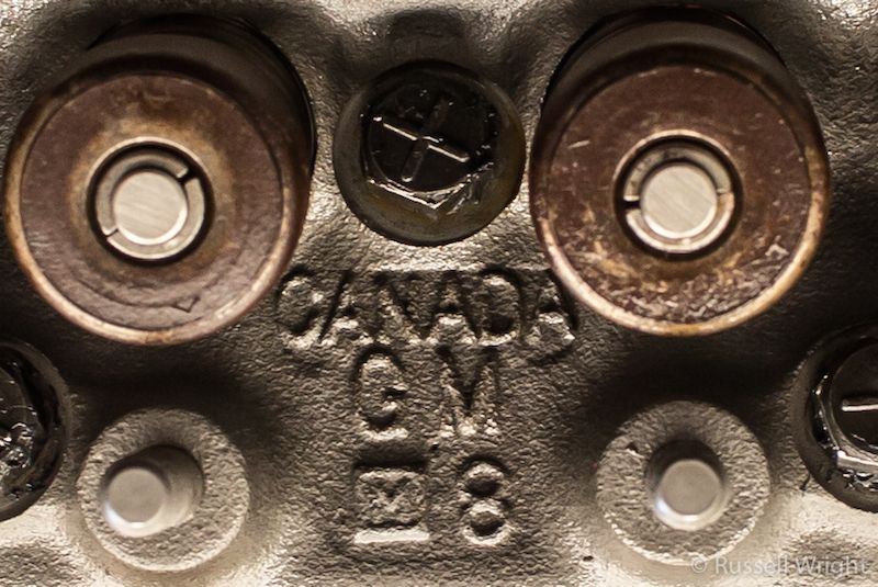

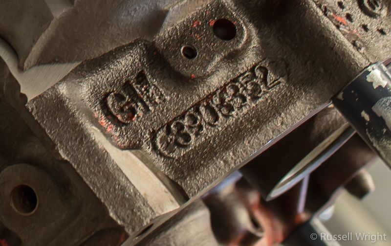

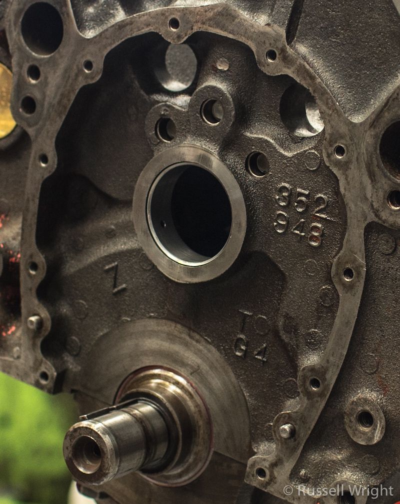

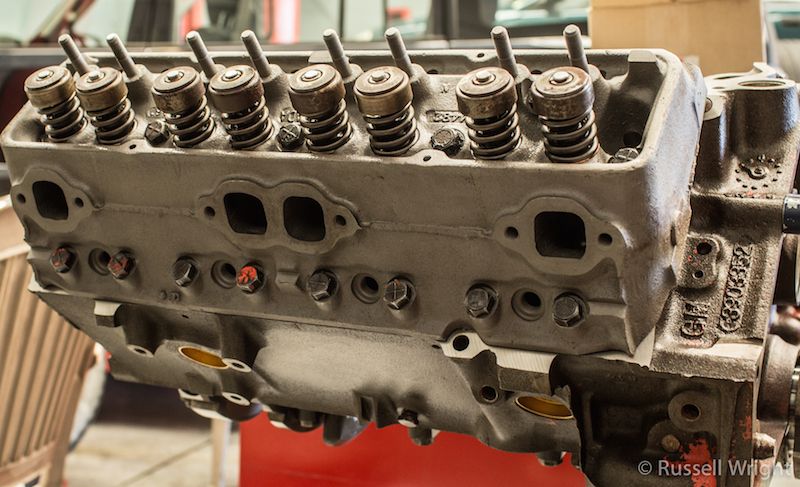

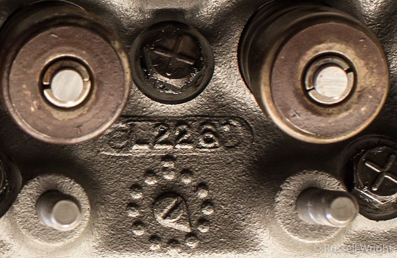

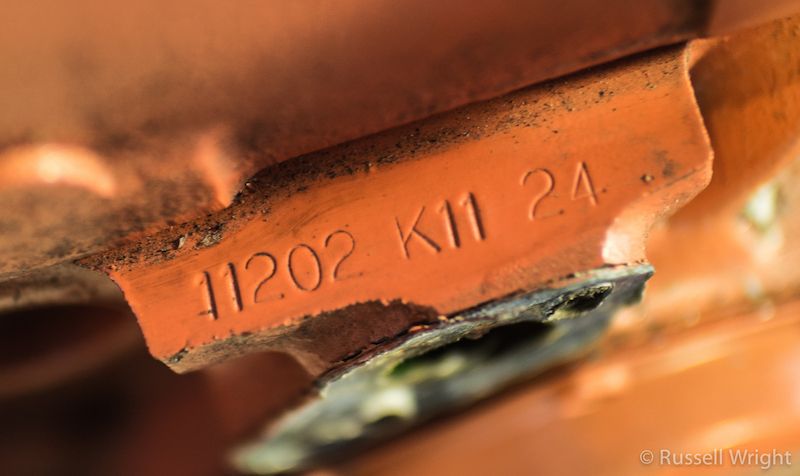

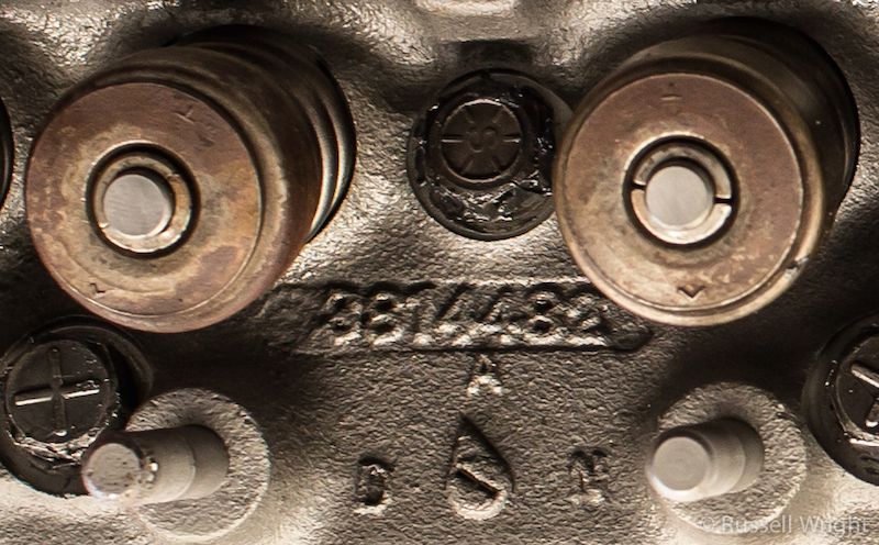

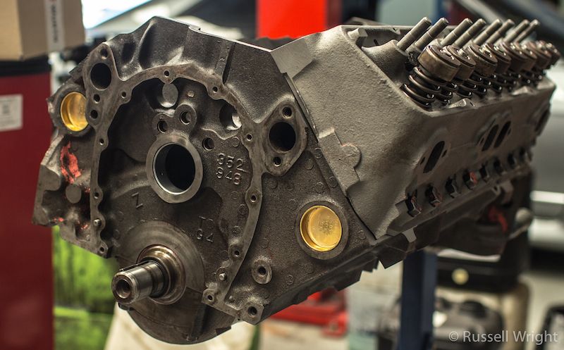

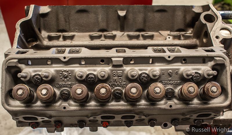

Sorry for the delay. Here's the photo's I could find of my 327 out of my RHD '67 Impala. Can't find the shots of the side casting numbers.
Block:
Heads:
#58 Posted : Wednesday, 3 February 2016 7:27:05 PM(UTC)
This one is essentially identical to the earlier one from the thread of FE327CHEVY's:
Tonawanda 352 block assembled by McKinnon Industries.
Canadian 482 heads.
A 5 digit number in the same font preceding the engine assembly code.
Any photos of the intake manifold?
This definitely came from a GMH assembled 1967 Impala? If so I reckon FE327CHEVY's also came from a 1967 Impala or Parisienne.
Do you know which GMH assembly plant assembled the car?
Edited by user Wednesday, 3 February 2016 7:28:47 PM(UTC)  | Reason: Not specified

That tallies with what I understood about the 3903352 block - Tonawanda only.
I thought McKinnon was well and truly up and running with 327 casting by then.
Why would they get blocks from Tonawanda, I wonder?
#60 Posted : Thursday, 4 February 2016 6:17:41 AM(UTC)
According to the info I have McKinnon didn't tool for 327 until 1966 and 307 in 1967. It doesn't say when in these years they started casting and machining either though, but I know the 307's were being cast and machined at McKinnon by 9/67 as I have plenty of early HK 307's cast and machined in September 1967. It is possible these are close to the last of their kind.
Those 3814482 heads are 75cc heads, which means the 1967 engines were about 8.55:1. So now we have plausible explanations for the 4BL low comp 327's power increases:
1966 was 230hp.
1967 was 240hp, increase due to the new Quadrajet.
1968 was 250hp, increase due to the compression ratio hike from just over 8.5:1 to just over 9:1.
It does appear that there were different casting numbers used between the US casting plants (Saginaw and Tonawanda) and the Canadian McKinnon plant up until 1969 when manufacturing was restructured. This is probably why the 3917290 head of the Tonawanda 1968 HK 327 head is a different casting number to the McKinnon HK 307's 3911032 although the heads are identical. Same for the HT manual 350 engines, they got 3947041 heads which look to be the exact equivalent of 3927186 heads, and Tonawanda 3947040 heads are the direct equivalent of Saginaw 3917291.
