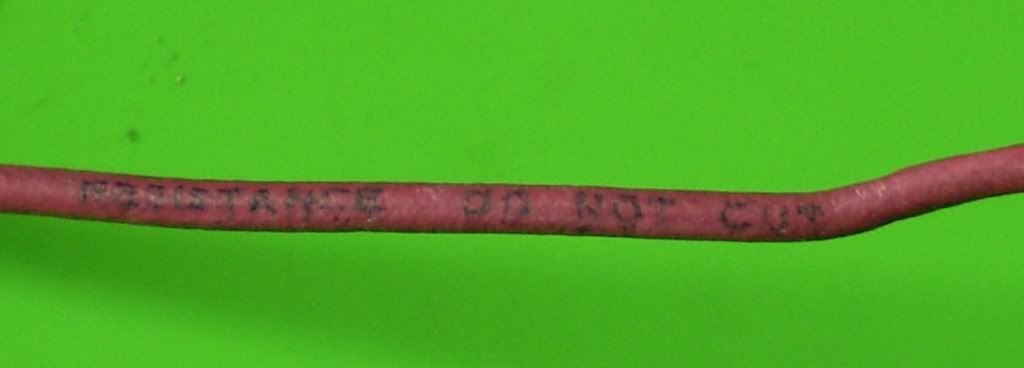

Yeh HQss, you're right.The wire I cut out was a pink wire with"resistor wire do not cut".The is a yellow wire that comes from the starter, that supplies 12V while cranking. Then when the key is back at on/run position, power comes from the pink resistor w

Yes, I forgot that the ballast wire in the later models is also pink. Both the pictured wires are ballast type. The reason is says 'Do Not Cut' is because it is Ni-Chrome wire & cannot be soldered.
The pink I'm talking about is a normal (co
