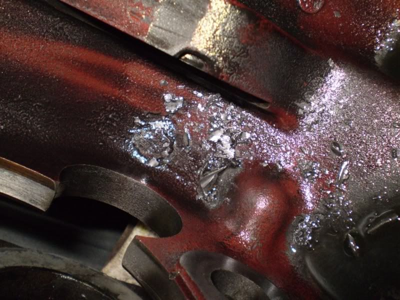

Fallingbear the most simple way I know of is to check the oil condition for bits of metal like this
Beyond that check in the housing for the same and check for worn and damage
