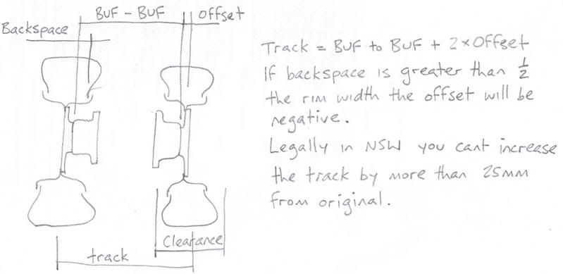

Hey just wondering what is the best way to measure the backspace for my rims.
im ordering a set of custom rims for my HK , has Hq discs front an rear.
let me know
dylan

It can be calculated from measurements see sketch.
