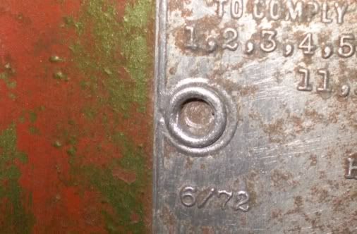

#17 Posted : Tuesday, 17 June 2008 11:46:16 PM(UTC)
The second way trim tags .com say to do it may be right for US cars but on a HQ a least it is wrong
This is what a std original HQ rivet looks like fitted.
So I would not be do
