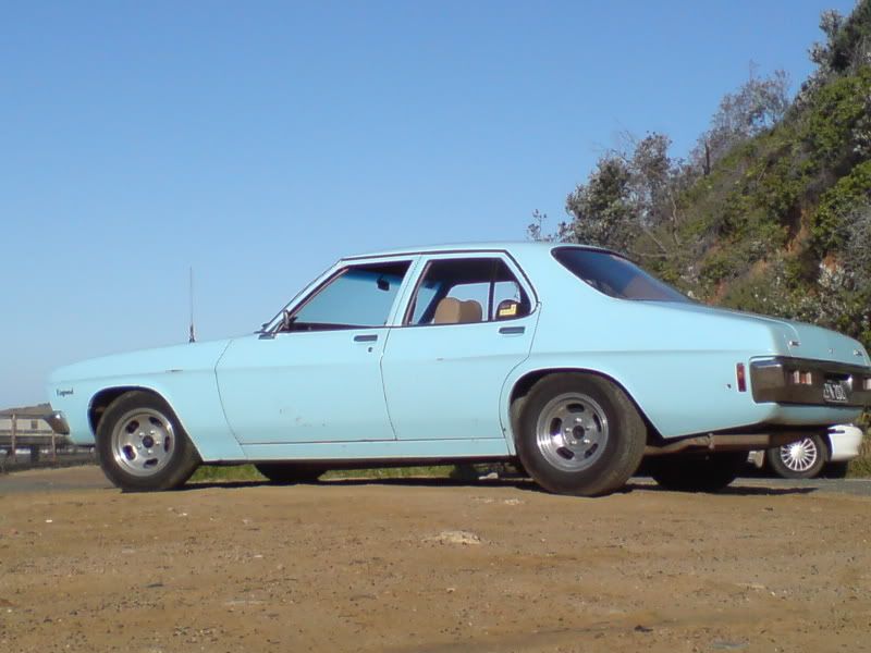

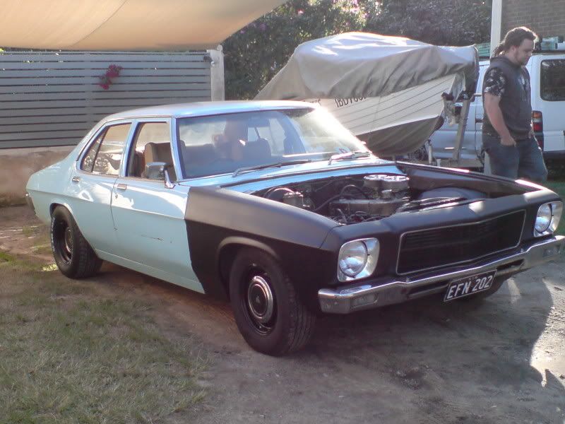

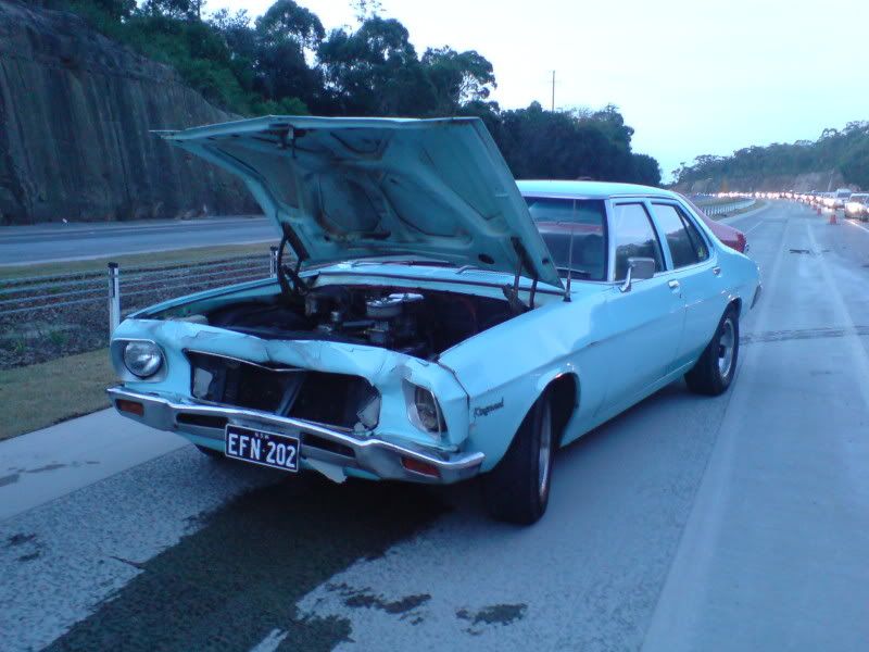

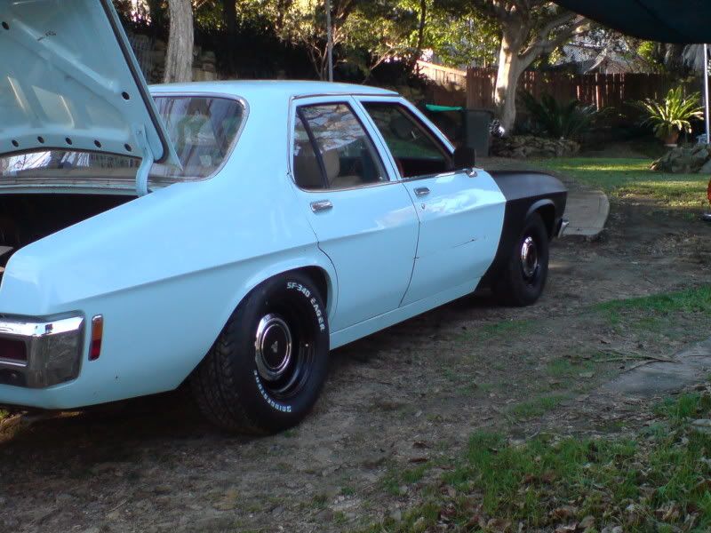

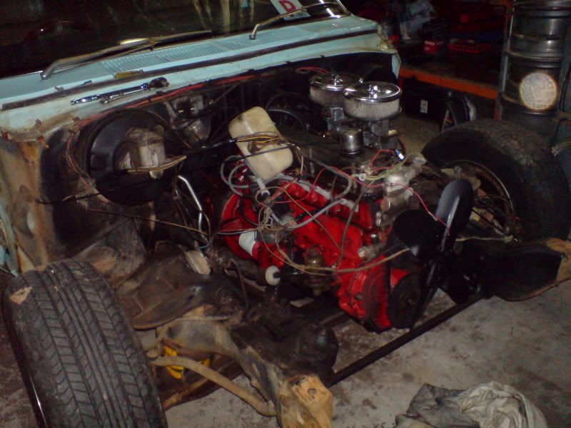

From this:
To this:
A little bit of work:

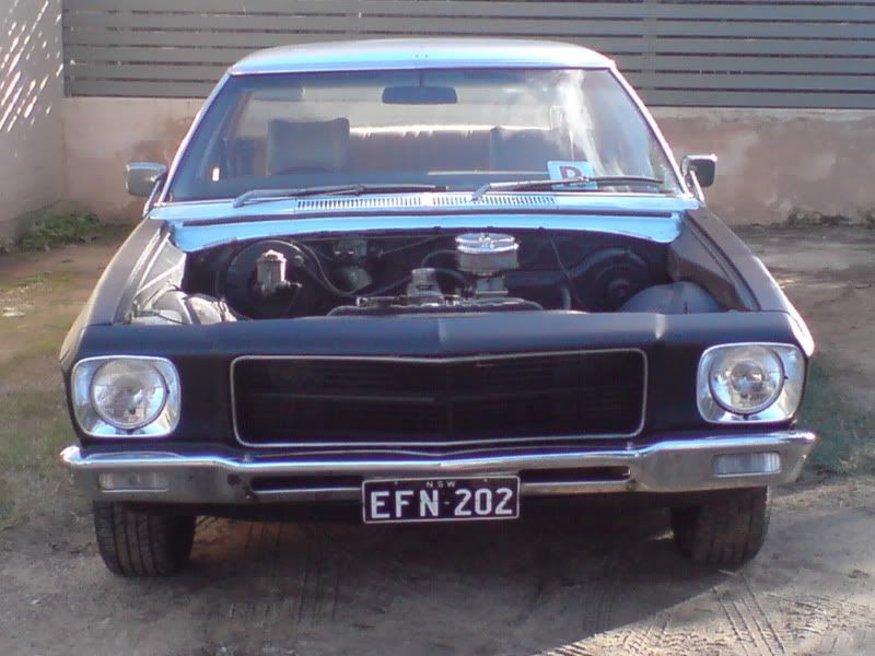

Few changes to the style:
And were back in business!
Thanks to Ebay and a few contacts i sourced a dead set mint front apron, straight bar, rust free RH quarter and i had the good bonnet already. Most of those panels you can see are roughie's until i prep and paint the good stuff.

#4 Posted : Thursday, 11 June 2009 7:35:15 AM(UTC)
darryl
Joined: 19/02/2009(UTC)
Posts: 27

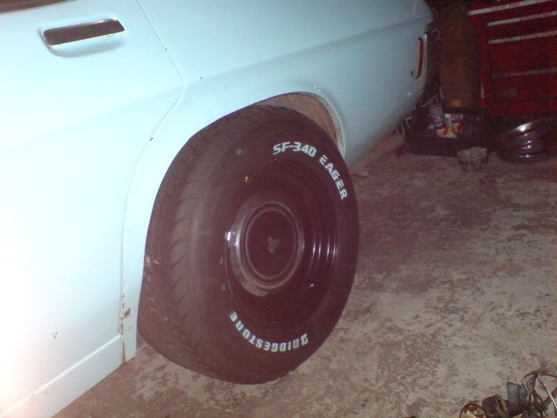

Hi, what size tyres are you running on the back?

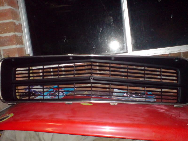

Thats exactly what I did with my grill as soon as I got it except I taped the two centre horizontal raised lines and they ended up silver with the rest black... It changed the look of the front end heaps!
What model are the clear indicator lenses off? Do you have orange bulbs under there? I really like them! Im not up with the old girl details : (

The clear lenses were on the 73/74 HQs

Gee I got that backwards the clear lenses were on the early HQs and the orange ones 73/74...

HQforme Offline
#9 Posted : Friday, 12 June 2009 5:18:55 AM(UTC)
HQforme
Joined: 14/06/2007(UTC)
Posts: 582
Thanks guys!
Tyres are 245/60/14. 8 inch wide steelies with plenty of dish means that they juuuust fit inside the guards and only scrub under full suspension travel. Im on Kings ultra low springs and shocks all round. Ill pay some attention to the inner guard lips soon.
Indicators are as was stated. My old ones were orange because i had the front bar off my old 74 HQ. This is a 71. These came with the front end i bought, so i got lucky. Standard (clear) bulbs.
That nosecone is the mint one, but every other panel will be replaced with the good stuff i have aquired. Itll be really, really straight when im done!
