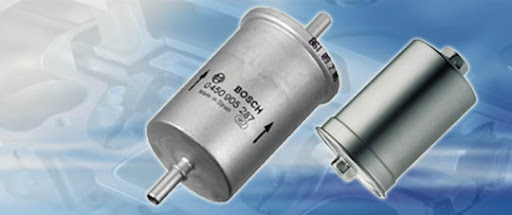

Just relocating the pump and filter on the G.
Is it OK to mount this Bosch type filter vertically??
Seems Ive only seen them horizontally, but vertically (fuel flow downwards) would be really helpful.
#2 Posted : Tuesday, 9 March 2010 8:49:35 PM(UTC)
Hi all
To anyone thats interested, Bosch have confirmed this will be fine as long as theres no air in the system, which will also be fine because of a low pressure priming pump and the fuel return system.
