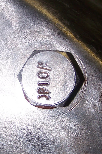

Hi Brains trust
Can anyone fill me in with what this means??
#2 Posted : Monday, 15 March 2010 5:55:09 PM(UTC)
Posts: 6,153
Was thanked: 243 time(s) in 217 post(s)
Hi Jeremy.
Its a number 1 oversize sump plug.
Sometime in the past, the sump plug thread has been stripped, so it has been re-tapped to the next size up & a new plug fitted.

#3 Posted : Monday, 15 March 2010 6:19:53 PM(UTC)
Thanks Terry
Thought youd know.
Should these use copper washers??
Also, the plug on the oil pump was cracked.
Should I replace it with a copper one too??
