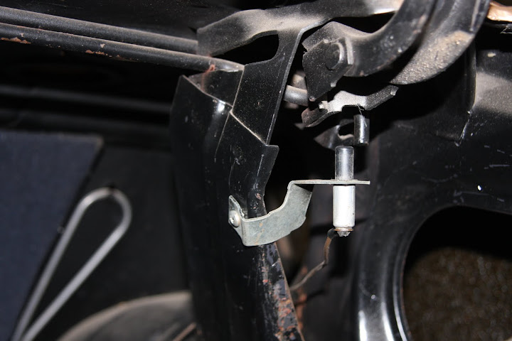

Was the boot light standard on hk gts? Would anyone have a picture of the switch mounting brkt for boot light,lost it and need my memory jogged.-keeo

#3 Posted : Thursday, 8 April 2010 7:48:23 AM(UTC)
Hi Keeo
Looks a bit like this

#5 Posted : Friday, 9 April 2010 3:41:34 AM(UTC)
Keeo
Joined: 26/10/2009(UTC)
Posts: 164
Thanks Dr Terry,Warren and Jeremy,top photo can see exactly what to look for.I know ive got that little brkt somewhere.It kind of looks like a glovebox hinge.eers-keeo
