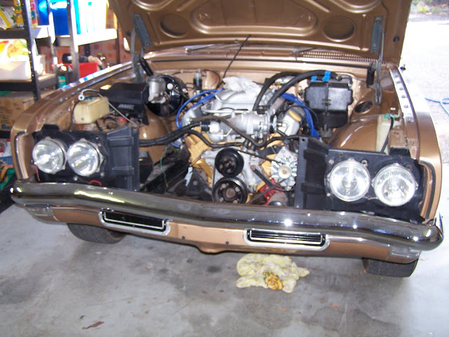

I don't like the look of the carby adaptors either. Guess everyone has their own method, here's a pic of mine. Two bits of angle iron bolted onto the heads in place of the manifolds. High tensile U bolts attaching chains (could use D Bolts if you want) Old rocker covers temporarily in place to save damaging the others. Didn't even remove the dizzy or starter before pulling the motor out. Pulled the box from the bellhousing, but it would probably come out complete.

Would this work equally as well for a 307? I want to leave the gearbox (powerglide) attached when removing the engine - would this hold the weight? What size angle iron did you use? As I don't have any old rocker covers any suggestions on how to protect the ones I have? Thanks.

Looks like 50x50x6mm angle it would handle the weight no problem.drain gearbox oil first is a good tip--keeo

Yep, a 307 looks identical to the engine in the photo.As Keeo says, it's 50x50x6 angle iron and it will hold the weight of your 307 plus glide. Just remember, "a chain is only as good as its weekest link" so make sure that everything else you use is up to the job. Guess you could use some thick foam or rubber to protet your rocker covers.

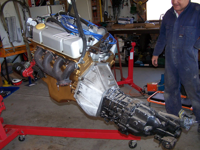

I used some 3/4" UNC (I think) 8.8 bolts and the chain you can see to protect the rockers and had a friendly Fastlaner help.....
Pulled the front off (and the bumper bar, but you don't really need to) and removed the bonnet.
Lifted it up with a jack under the gearbox, adjusted lowered it down as we hoisted the crane and when it was free we pushed the car out fromunder it....
Worked a treat.

My 307 and saginaw was perfectly balanced when lifted by the exhaust manifolds in the rear ram horn.
Came out no problem.
