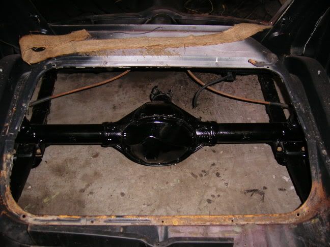

can any body tell me how to identify a chevy 10 bolt diff ie ht monaro

HK T G 10 Bolt

is there any id numbers on them or trademark features

Rear Axle Codes
CA 2.73:1 Locking CK 3.42:1
CB 4.10:1 GX 3.08:1
CG 3.73:1 GY 3.08:1 Locking
CJ 3.42:1 Locking GZ 2.73:1
Rearend Code Example: CJG100DE - (Chevy sourced 3.42 Posi, Assembled on day shift of 100th day of the year w/ Eat
#5 Posted : Sunday, 15 October 2006 9:24:27 AM(UTC)
it only says PERFORMANCE DIFF on the tag .i cant seem to find any other numbers. any other ideas ?
