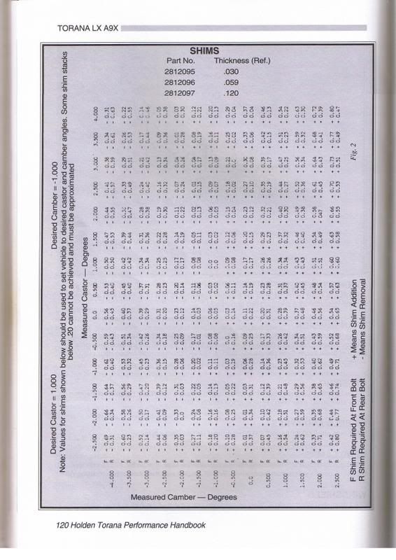

Is this chart reliable?
I know this is for Torana but may be applicable to the HQ-Z front end.
