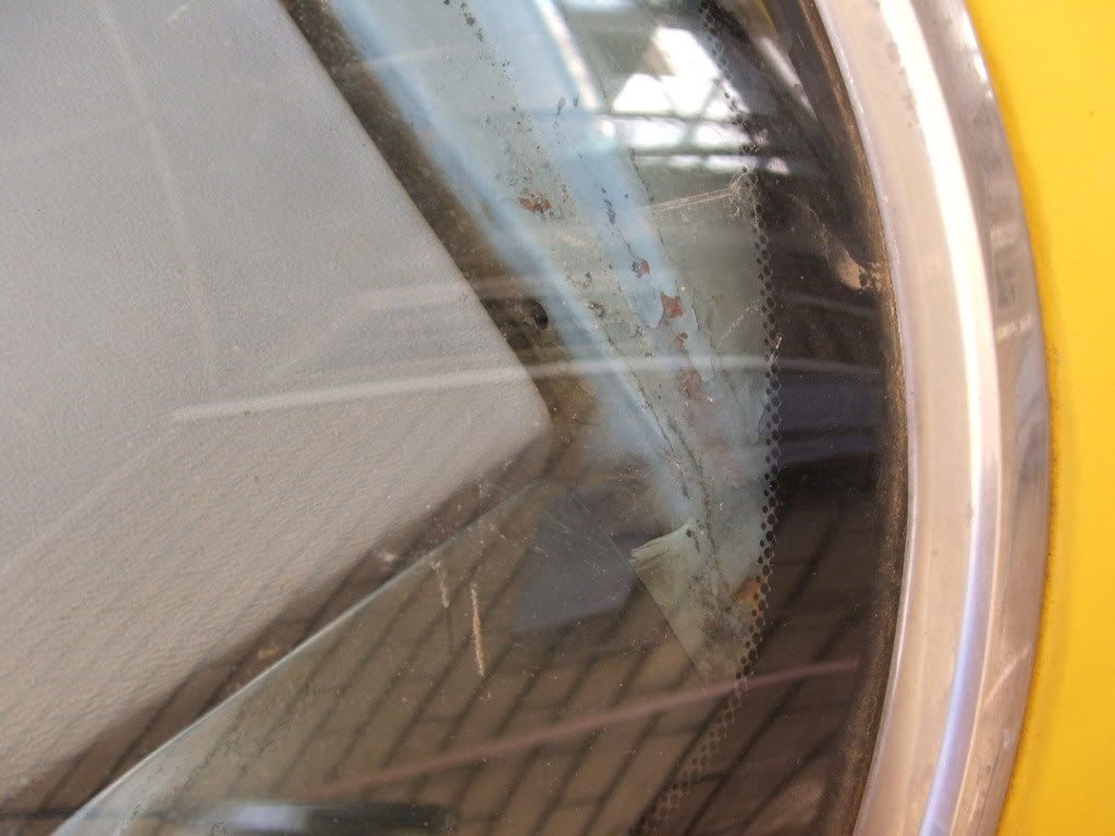

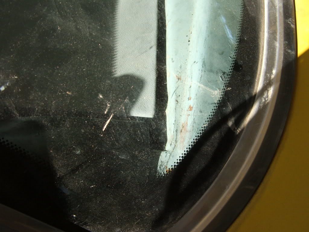

I have photos of my HJ GTS and HQ GTS dashes stripped to the bare bones and the whole structure in completely different.
I can see why this guy was given conflicting information now though. No one seems to know. :-)
