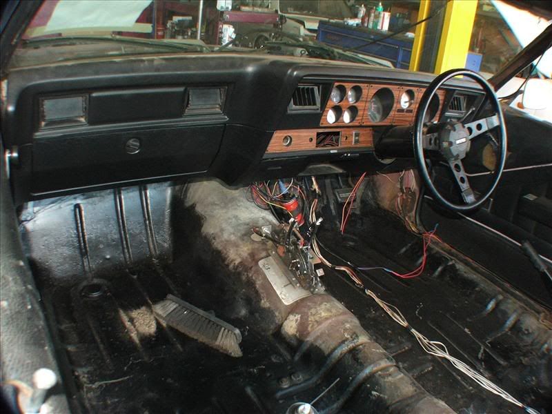

Ok so my HQ coupe has had a Dash swap some where along the line, im not 100% if its a HX LE or a SL/E Stateman Dash but it is Woodgrain, any ways, i want to return to original HQ Dash, what exactly do i need to swap back?
Also some one told me that to fit a HJ/HX/HZ Dash in a HQ you had to cut some metal out???? why is this so? and how can i tell if some was cut on mine?
If this is cut can i still put the HQ dash back in??
Cheers...
My dash:

The car is really a HQ all the build plates say so and match the chassis number, the dash was smash in half during an accident in the early 90s, and was replaced with current dash.
So what exactly would have been changed to fit this dash

It's a HX Premier woodgrain GTS dash. You will need to find a donor HQ that you can cut the whole dash out of .... glovebox to gauge panel. Easiest way is to remove the windscreen and cut along the screen line to remove the entire dash, the welds will be

Its a HX Premier woodgrain GTS dash. You will need to find a donor HQ that you can cut the whole dash out of .... glovebox to gauge panel. Easiest way is to remove the windscreen and cut along the screen line to remove the entire dash, the welds will be h
