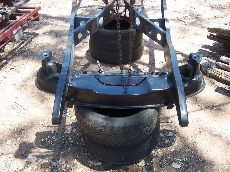

I have a hot rod project that uses a HT Holden subframe but my suspensions arms are not suitable for reuse.
Can the HG suspension arms be used on the HT subframe.
http://i109.photobucket....mouthChassiswithHTHo.jpg

#5 Posted : Sunday, 1 June 2008 8:19:15 PM(UTC)
Fom July 1969 HT and HG front ends are the same. The first month or so of HT had the same upper control arm mounting locations as the HK, but they were raised in July. The wishbones are the same though. Just make sure you have HT/HG ones though as HK won'
#6 Posted : Sunday, 1 June 2008 8:19:15 PM(UTC)
Fom July 1969 HT and HG front ends are the same. The first month or so of HT had the same upper control arm mounting locations as the HK, but they were raised in July. The wishbones are the same though. Just make sure you have HT/HG ones though as HK wont
