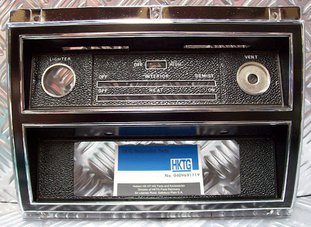

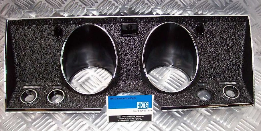

Hi Shane
Try Simon Pinnega from HKTG Parts Recovery.
[email protected] or 0409 691 119.
Hes in SA and hes a really knowledgable guy with lots of contacts.
Goes by *69cult* on eBay, Oldholden and Facebook.
He can restore any thing on these cars.
He sent me these photos of a dash he restored.
Not sure what it would be worth (probably not cheap) but I trust him to do a good job - hes passionate about his work.
Hes helped me heaps.
