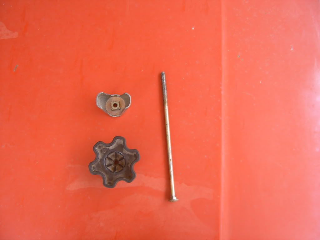

Thanks for the info guys, would never consider buying what was being sold, just using it as a reference for what i have lying around at home as of the 7 HQs Ive owned have all been different! Found this spare wheel retainer bolt, <a href="http://s954.photobucket.com/albums/ae26/monarosteve/?action=view¤t=SUC56624.jpg" target="_blank"><img src="http://i954.photobucket.com/albums/ae26/monarosteve/SUC56624.jpg" border="0" alt="Photobucket"></a> . Is this the spacer you guys are talking about? The retainer bolt is 21.5cm long and Im assuming it mounts through where the wheel cap goes so its too short.

Steve,
go and see Chris (with the HG 350)... when he was last at my place I gave him a full original kit including the foam holder for his HQ...
the tools and jack were with the kit.... the spacer you can get off andy... chris knows andy...
Al

Thanks Al, I saw Chris on the weekend but forgot to check out his kit as he had his HQ with him too. I have emailed Andy a few times about various things so might be time for another one. Its so hard trying to sort out whats what a lot of the time as stuff has rather been changed or missing and Ill never trust an ebay seller unless Im 100% sure it is what they say it is.
