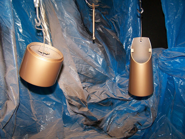

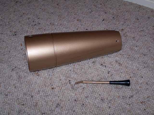

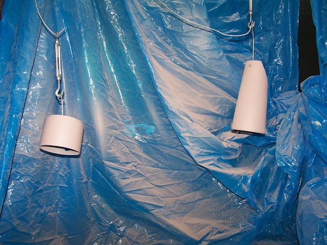

#8 Posted : Friday, 18 December 2009 8:16:22 AM(UTC)
Hey Jim
What do you reckon!!!
Not bad eh!!
Edited by user Friday, 18 December 2009 8:18:37 AM(UTC)  | Reason: Not specified
#9 Posted : Friday, 18 December 2009 8:34:26 AM(UTC)
Pretty good. Now you are ready to spray your engine covers.
Oops wrong Jim but who cares as it looks good to me too.
If at first you dont succeed then skydiving is not for you.
#10 Posted : Friday, 18 December 2009 8:41:28 AM(UTC)
Thats right Jim
Onto the next painting project.....
Only 34 million to go...
Actually I need to get this column back together and installed first.
That is after I pull the dash and fix up the wiring and get the tacho and oil guage working and then.....
So much to do, so little time.
#11 Posted : Friday, 18 December 2009 8:49:27 AM(UTC)
right jim and i agree with wrong jim looks good...
#12 Posted : Friday, 18 December 2009 9:08:33 AM(UTC)
You told me it was simple Jim
And it was - but next time Ill do a better job.
Except hopefully itll outlast me.
