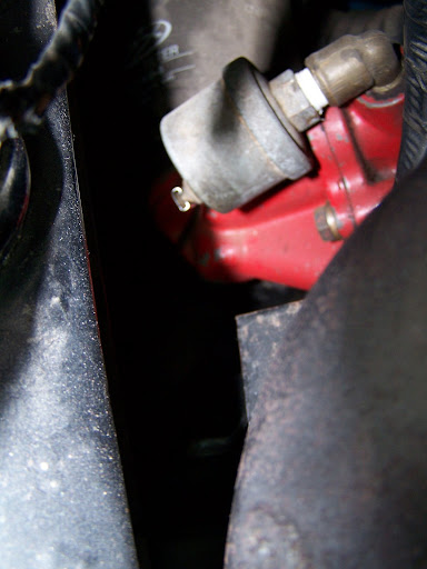

#7 Posted : Saturday, 12 December 2009 11:35:04 PM(UTC)
Thanks Warren
Ive attached a photo of the one thats in the car now.
Do you reckon the elbow could be a problem??
Also, is the plumbers tape cool???
#8 Posted : Sunday, 13 December 2009 4:49:21 AM(UTC)
Right again Warren.
Just pulled it out and it reads 6/77....
So that would make it most likely HZ...
OK - Im on the hunt....
