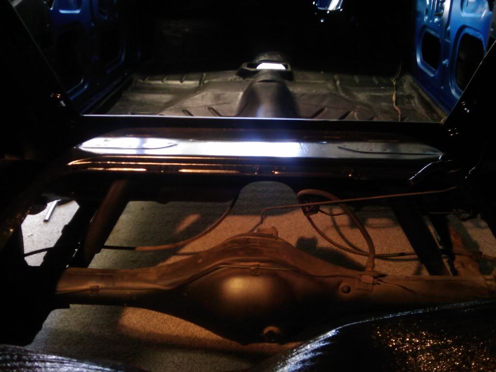

Info needed for Monaro HT. Its plated HT80737 but came with 307 Chev, Powerglide and banjo. Has got 5ltr badges on GTS guards that appear to be original. Appears to be proper Powerglide tunnel, console and shifter/linkages. HK disc brake front end. HG bonnet, grille and taillights. All V8 parts are consistant for era and dont appear to have been altered from 6cyl.
Car was purchased about 20 years ago and therefor wouldnt have been modified to current spec just to make it more valuable. Car was Daytona Bronze with black interior. Can someone also confirm if this boot has the hump for Salisbury.

ACC 11 = 11th month, ie November
On HT, powerglide and opel floor is the same, saginaw is the only other floor in HT.
No it is not a salisbury floor in the rear.
20 years ago they were 20 years old and everyone was fitting V8s because it was very cheap to do so. A typical 307 glide to banjo conversion was about $500 - $1000. We converted a mates panel van by buying a running 307 Kingswood for $500. This would only be about $2000 today. Broughams were also dead cheap at the time.
A fellow I worked with converted his 186S daytona bronze, sandalwood roof sandalwood houndstooth trim to 253 4 speed in 1987. It happened to heaps of 6 cylinder cars. They were considered not worthy as a 6, so many just converted them so that people did not belittle their cars by saying "too bad its not a V8"

Thanks Warren. Assumed as much but owner wondered why so many things werent even consistant with all parts from one donor car. Was told when purchased that the vehicle was assembled at Holden from parts leftover, hence the inconsistantcies. Any chance of a pic of what the salisbury boot floor looks like? Just a link if theres a pic already somewhere would be fine thanks.

In HT there were no "left over parts", but you get stories like that all the time.
The salisbury floor just has a slight rise in the centre, nothing too specataculer. But sorry do not have a photo handy. A salisbury willgo in without the hump being there, but saginaw would require an floor mod (possibly with a sledge hammer).
The car sounds like a bit of a bitsa, but unless you are trying to restore to original, would not be a problem. The floors look good, so hopefully the rest is good enough to make a nice car.
