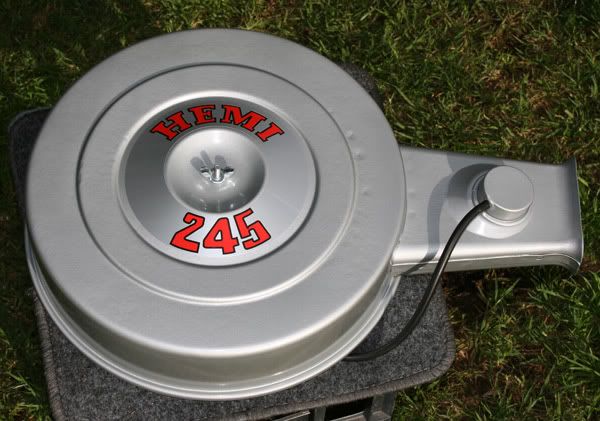

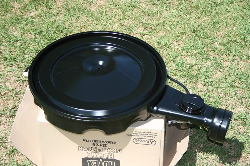

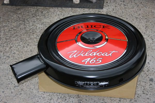

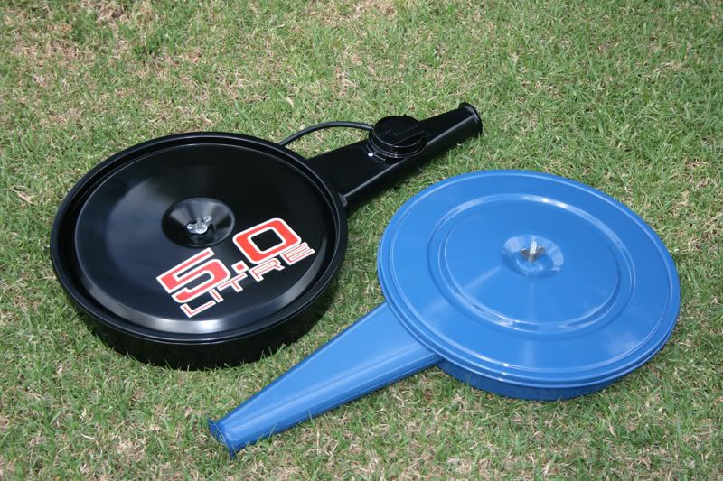

Generally if they need panel work then they are not worth the trouble unless an early/hard to get type. And the snorkels are that thin you can tap them in and out of shape without trying. I sandblast and powdercoat some, others cant be blasted like original tin coated Hemi.
I think I know the guy on ebay you refer to, often has an HQ aircleaner for nearly $400, and later versions with bare metal photos during sandblasting and pre-heat valve still in place, hiding the rust under it no doubt!
Anyway, what did you say the differences in snorkel were for HG/HT and early HQ models? I have 2, want to decal correctly.
A few samples of what I play with!
6.6L Firebird
HJ/LH (with later model lid!) and P76
VJ Charger
Buick Wildcat
