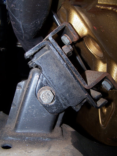

#12 Posted : Tuesday, 2 February 2010 6:49:08 AM(UTC)
Team
Heres a pick of my mounts that Jims mentioned.
Byron suggested theyre HQ mounts.
I am having problems with height of the shroud (HQ) and fan (square blade commodore).
I went to Rare Spares locally and checked their HG shroud and it has not got enough difference to make the fan work.
But I do remember the HG fan blades were rounded off.
Maybe that with the different HG mounts might make the fan/shroud work.
If only I could scam a HG fan to test my theory without paying for it....
If you ask nicely I might find a photo of Jim5.0 to post....
Edited by user Tuesday, 2 February 2010 6:52:55 AM(UTC)  | Reason: Not specified
#13 Posted : Tuesday, 2 February 2010 9:11:42 AM(UTC)
If there is a difference it must be in the rubber mount. The steel adapter is the same physical dimensions, just the way the mount attaches to it is different. If I had a HQ rubber mount I could put it and its adapter side by side with a HT/G adapter and rubber mount. I do remember doing it once though (with new rubbers) and with the steel bits side by side on a flat surface and the block bolt holes aligned you could stick a piece of 12-13mm bar right through the slots on both rubber mounts, hence the combination of adapter and rubber mount together should leave the motor sitting in the same place. So in the above photo, if you pulled the HQ-WB mount and adpater out and replaced it with a HT/G adapter and mount the block would remain where it is. Ill see if I can dig up a HQ mount and take photos... I think the last ones went with some SBC into HQ adapters I had.

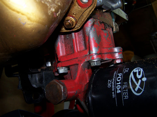

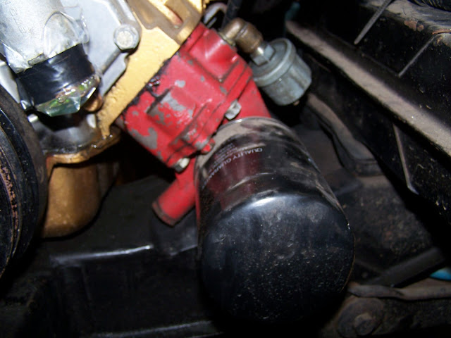

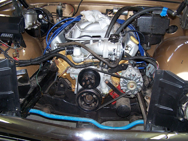

#16 Posted : Wednesday, 3 February 2010 3:56:02 AM(UTC)
Hi Terry
Heres a pic installed.
And heres a close up with the Holden written on it - cant make out the part number, but Im sure you know what it came out of - Maybe HQ as well??
Here it is in the car.
Thats all for now :)
PS - No one wants to see a photo of Jim5.0 apparently.....
Edited by user Wednesday, 3 February 2010 3:57:20 AM(UTC)  | Reason: Not specified
#17 Posted : Wednesday, 3 February 2010 5:40:04 AM(UTC)
HQ-WB? oil pumps are a bit different to VN onwards, especially the location of the hole for the sensor/switch. Maybe this is why? Ill look at some in the shed tomorrow and see how they differ.

[HG HOLDEN } any body put 308 with vn heads and extractors in to hg holden and knows clearance i got problem LH is ok RH 2mm clearance any idea i have changed mounts thought that was it no change
#20 Posted : Monday, 4 February 2013 6:14:36 AM(UTC)
Have a close look at JPB's photo's above. What you are looking at is a 308 fitted with VN top end and injection.
