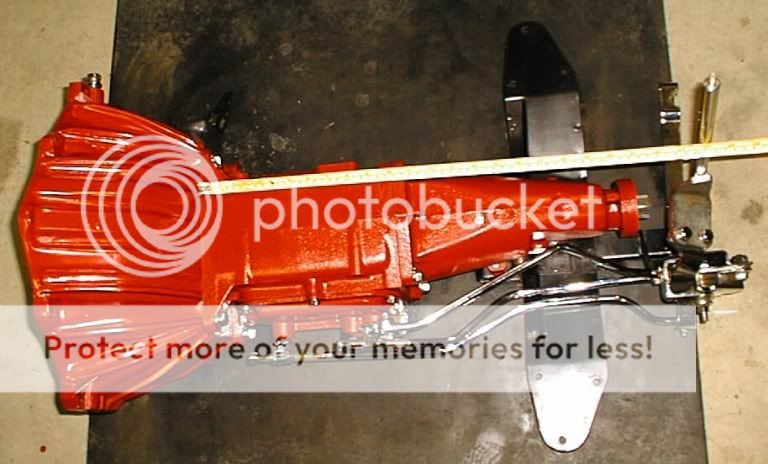

If he wants to use the correct bits, theres a photo below of a correct 327 gearbox. A couple of notes ......
The shifter is attached to the rear mount
The rear extension does not have 3 shifter mounting holes
The Release Fork can just be seen on the RHS of the Bellhousing
The chrome bolt at top left is where the Slave Cylinder assy bolts on
You can see that the Shift Rods stick out a bit, hence the need for a bit of work on the floor pan.
Ignore the tape measure, I was doing some comparisons between a Saginaw and a Supra
