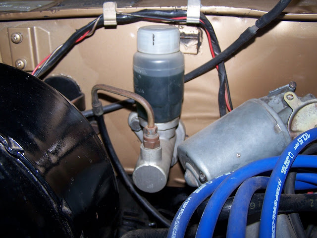

#1 Posted : Saturday, 27 March 2010 6:04:31 PM(UTC)
Morning gents
Another question for the learned.
1. Which vehicles would have had a hydraulic clutch setup??
2. Would this have been a factory brake master cylinder, or aftermarket??
The body has no branding, has some fairly undecipherable number stamped down the side and has 6G0 stamped on the front (6/6/70??)
Reservoir is PBR and the slave cylinder is also PBR.
It lives on the firewall as below.
#2 Posted : Saturday, 27 March 2010 7:40:00 PM(UTC)
Posts: 15,088
Was thanked: 618 time(s) in 584 post(s)
HK with crash box, GTS 327, 307 4spd, HT/G GTS350M.
It looks factory. Ive got a NOS cylinder body in the shed, ill see how close it is. There were a few hoses from memory but ill check: HK V8/HK LHD crash box and HT/HG 350M and RHD crash box.

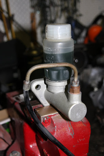

#3 Posted : Saturday, 27 March 2010 8:21:21 PM(UTC)
Its a PBR Replacement type .
www.monaromuscleparts.com

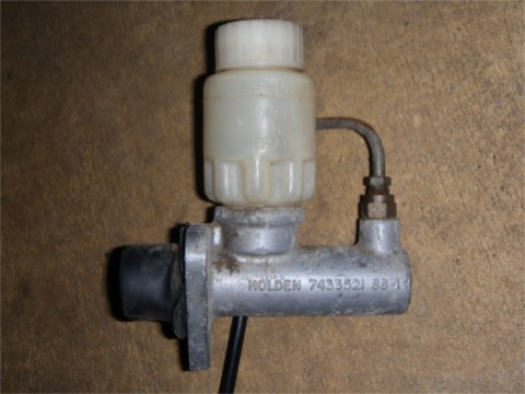

#4 Posted : Saturday, 27 March 2010 10:04:44 PM(UTC)
Thanks
Just did a search and found this one - must be the factory one - looks almost exactly the same except for the PBR branding.
Thanks again

#6 Posted : Sunday, 28 March 2010 1:47:16 AM(UTC)
Thats the one , short hose (about 18inches ) is only HK 307/327 Manual and all others are the long type .
