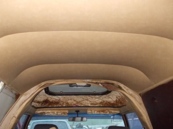

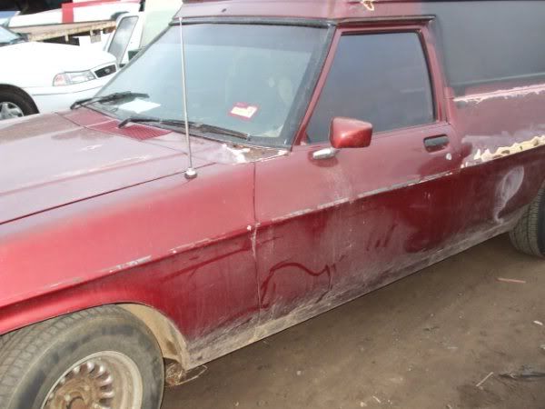

Hey guys, still determined to find an origonal Sandman
after my last post (which I didnt buy the HX that wasnt a Sandman thanks to you guys) I have another possible Sandman.
Owner says 1977 HZ Sandman origonally Yellow with blue decals. I am just waiting on pics of the id tags
Heres the pics so far (needs full resto):

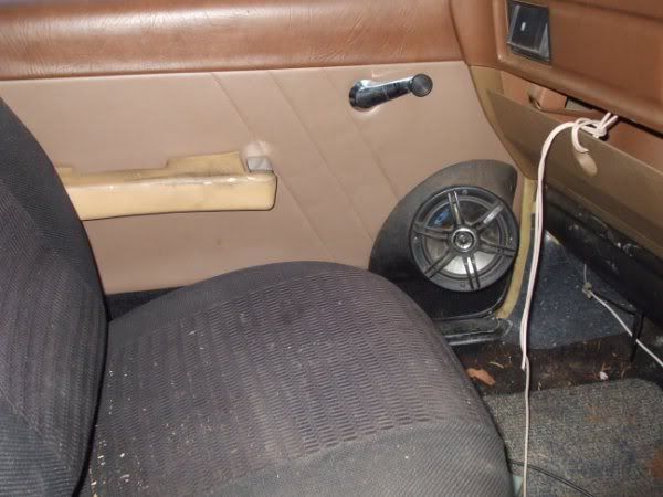

only thing that doesnt look sandman is the door cards.
Because its HZ get the tyre placard part number also. Also scratch the paint on the door handles. See if its chrome underneeth? It shouldnt be.
Like you say id tag details is really what you will have to wait for.

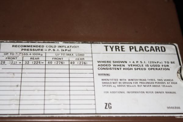

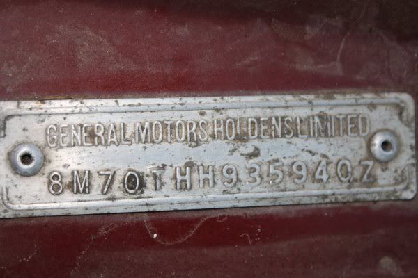

Hmm I think this could be the one, what do you guys think?
#4 Posted : Monday, 26 April 2010 8:43:34 PM(UTC)
Cetainly is a Sandman. GVW gets you almost there, but the tyre placard is the clincher. I know it could be changed but everything else points there too.
#5 Posted : Monday, 26 April 2010 9:00:56 PM(UTC)
None matching tags,as per adelaide usual,did you get the chassis number?
but I agree ,it looks like one to me,too many things line up.

Im not afraid of a little hard work and Ive got a couple of good mates that are into cars as well and have already offered their help and support. The seller is looking for around the $5k mark as well. The one thing that puzzles me is that there is no XX7 or XU3 anywhere on the plate. Is that normal?
#8 Posted : Monday, 26 April 2010 10:32:30 PM(UTC)
Yes "normal" to not have that(XX7) only one assembly plant(Acacia Ridge)that did that.There is a fair misunderstanding about that.It is not the defining
proof of a sandman as many believe,as a matter of fact,there isnt ANY one
thing that is,to my knowledge.Seating capacity (2)is the best I know of
BUT it still doesnt mean it is.ALL THINGS MUST LINE UP AND THAT ONE SEEMS TO.
