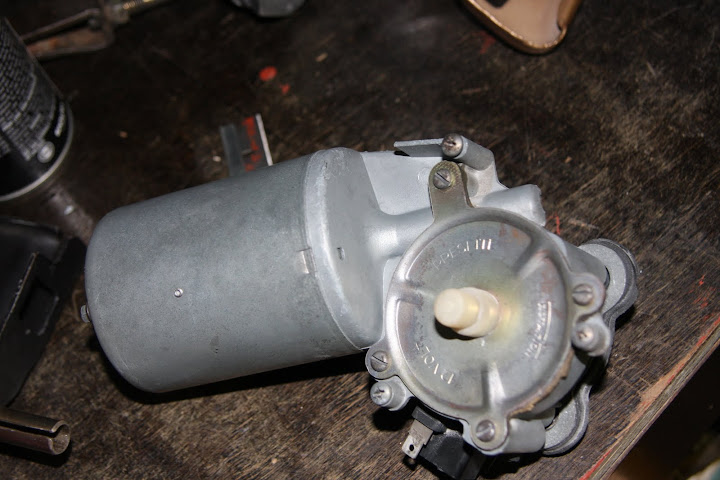

Can someone explain the preslite/trico wiper motor thing to me?
My car has a preslite wiper motor like the picture below.
It seems to have the screws on it to bolt the trico pump and the wiring that goes back to the washer bottle pump looks dodgy.
So my question is, did the HG come with the Trico pump from standard and they were replaced with the washer bottle pumps when they failed??
Pic of the pump I'm talking about here.

Yes they all had them as standard and were generally replaced with the washer bottle pumps. This is commonly seen in them.
The wiper motor in your photo has come off a Belmont. The cap in the centre was used on the Belmont (and factory air) models. You'll need to remove it to fit a Trico washer pump.
