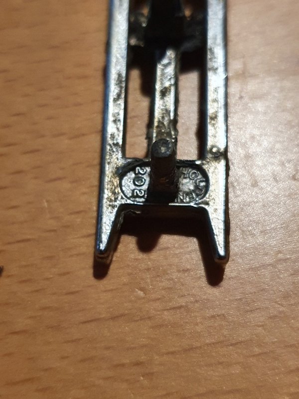

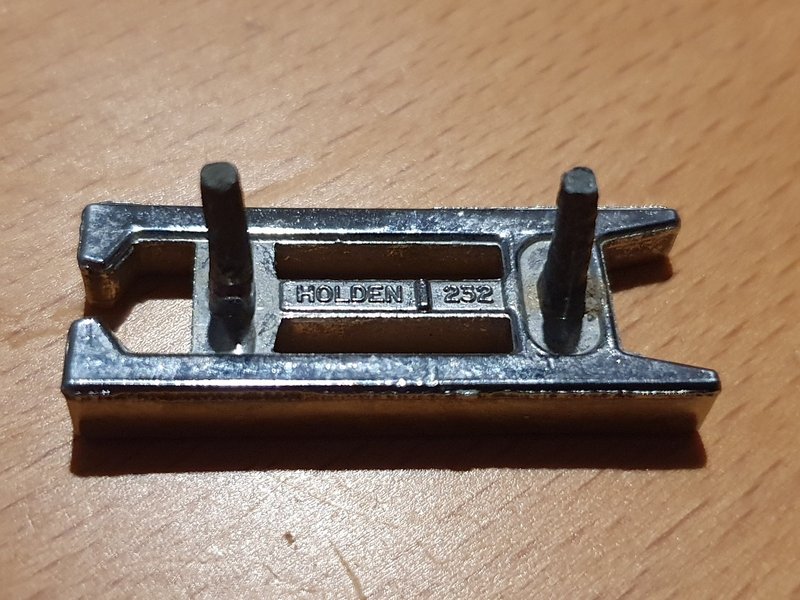

Thanks for the info! Here are some pics of the casting info.
Any idea on the flat vs tapered letters? The last pic shows the difference.
H
Castings
tapered v flat

E 232
E 202
#6 Posted : Wednesday, 3 June 2020 7:51:39 AM(UTC)
To my knowledge the flat letters appear on EJ & EH & reappear for HT (bonnet).
The tapered ones are for HD & then HK, this includes the P-R-E-M-I-E-R letters.
The EJ/EH/HT letters have parts nos. 7415xxx, while the HD/HK ones are numbered 7424xxx.
