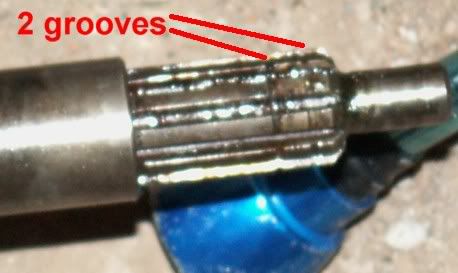

Any body know what this gearbox is? behind 253 in hq
input spline = 10. input groove/ring = 2. output spline = 27.
#2 Posted : Friday, 18 August 2006 8:05:18 AM(UTC)
Was thanked: 35 time(s) in 33 post(s)
M21 has 2 grroves on the input shaft.
Here's a pic for those who aren't sure what it looks like:
http://i29.photobucket.c.../VKengine/M21grooves.jpg

Cheers mate. I found website last night that said 2 grooves is m20 and 1 groove m21, but that only had production date up to 1974. Is there any numbers that i could check out??
#4 Posted : Saturday, 19 August 2006 2:57:21 AM(UTC)
Dunno what the numbers on the box say actually, but that box came out of a 1985 VK V8, which only got the M21 option (or a T5G from HDT), and it definately has the 2.54:1 first gear of the M21 in it!
