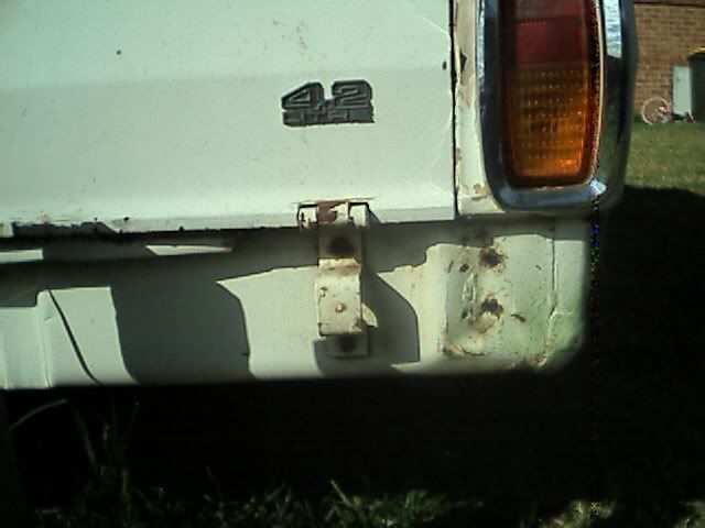

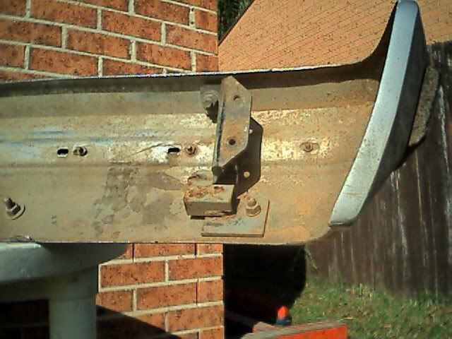

Make up some brackets like these and drill new holes in the back of the van .
Yes the tailgate will drop dow
