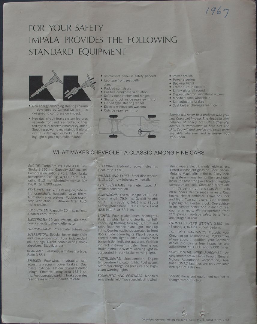

Just for reference, here's the info page from the brochure of the 1967 RHD Impala.
Regarding the engine it states:
Engine: Tubro-fire V8
Bore: 4.001 ins.
Stroke: 3.250 ins.
Capacity: 327 cu. ins.
Compression ratio: 8.75:1. Max
Max Brake HP: 240 @ 4,800 rpm
RAC Rating: 51.2 HP
Max Torque: 325 lbs/ft @ 3,200 rpm
I also have the brochure for the 68 RHD Impala, and the engine specs are identical.
Click here for high res: http://i33.photobucket.com/albu...67RHDImpalaBrochure5.jpg

The '68 Impala 8.75:1 327 is 250hp, here is the sales brochure:
https://myclassicgarage....t-impala#sales-brochures
Click on the 2nd column, 4th row.
The GMH one is an auto with a single exhaust. The manual and dual exhaust of the GTS327 (and the US Impala) would probably account for the extra 10hp.

Except that prior to 1972 GM and other US manufacturers rated engine power (very loosely) in SAE gross horsepower, which excludes ancillary items, such as exhaust systems. I think it's generally accepted that most power claims from the period were rubbery numbers.

They probably were, just trying to account for the 10hp difference between GMH's 240hp claim for tha Impala and 250hp claim for the GTS327 and the US Impala. GMH did this a sometimes claiming different hp figures for single and dual exhaust, rarely in advertising though.
#16 Posted : Friday, 8 August 2014 5:57:02 PM(UTC)
Yes, the figures were quite 'rubbery' weren't they.
The same can be said for the HK/T 307, 200 bhp in the US & 210 bhp in Aust.

The '68 brochure on your link shows the 1968 327 as 250hp. So the difference is probably the change from small journal to large journal engine and whatever difference in hp that entailed.
http://s33.photobucket.c...aBrochure5-1000.jpg.html
