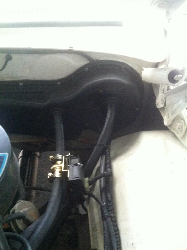

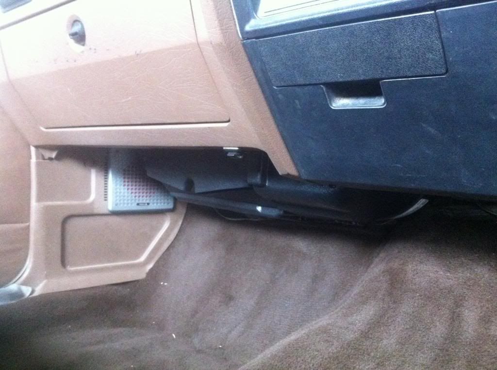

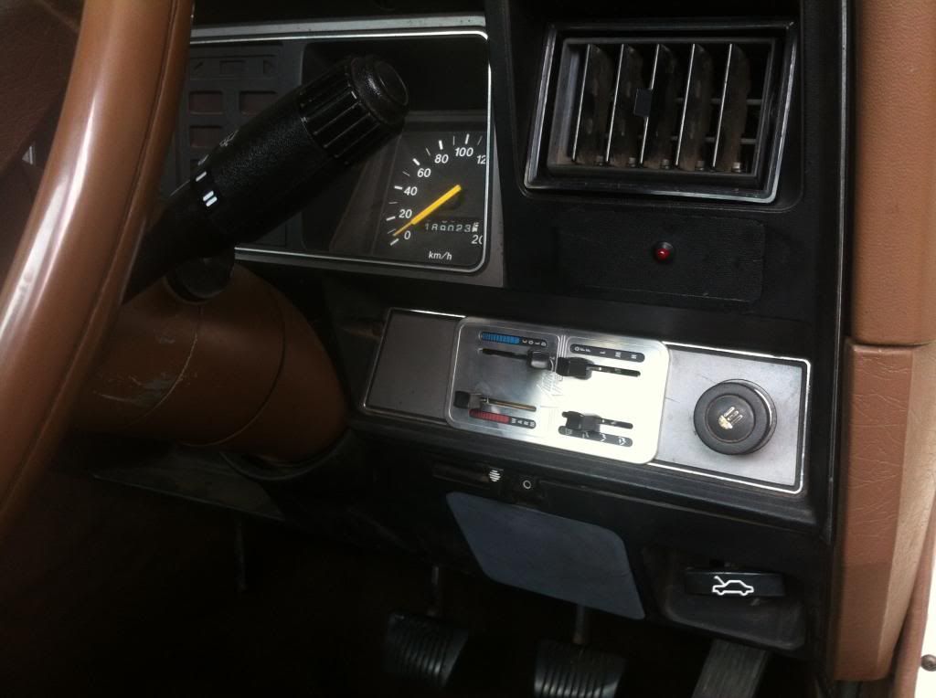

Here is some photos I found of a HX-WB conversion using what looks to be the GenII Compact system:
http://i818.photobucket....zl19/120_zps1a90d2e6.jpg
http://i818.photobucket....zl19/121_zps608bdd5c.jpg
http://i818.photobucket....zl19/122_zps253c2014.jpg
http://i818.photobucket....zl19/123_zpscf6b4daa.jpg
