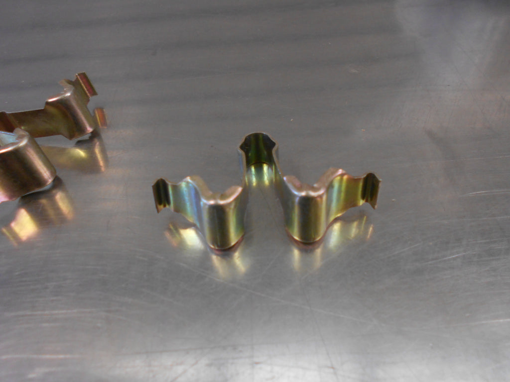

Thanks, is there a knack to getting the side clips out?
yeah.... long screwdriver and push down hard on one of the recesses of the clip (which is on top of a rubber mounting block)
then while pushing down, lean screwdriver over (towards the side of the car) and release the tang on the clip out of the body panel
pics might assist
