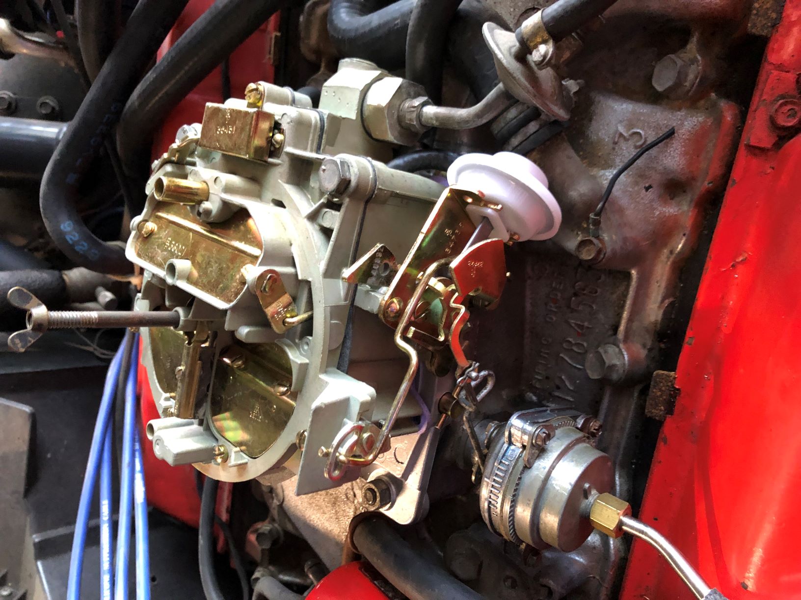

It a Rochester Quadrajet. The exhaust manifold on that side has a pipe through it and there is an insulated pipe that runs to where the arrow is pointing to. The other end runs up to the air cleaner so it is clean air. I'll edit this post and attach some images of my HJ, same engine.
Note you can buy the pipes aftermarket in stainless ready to go with insulation. That is what is on those images of my Premier.

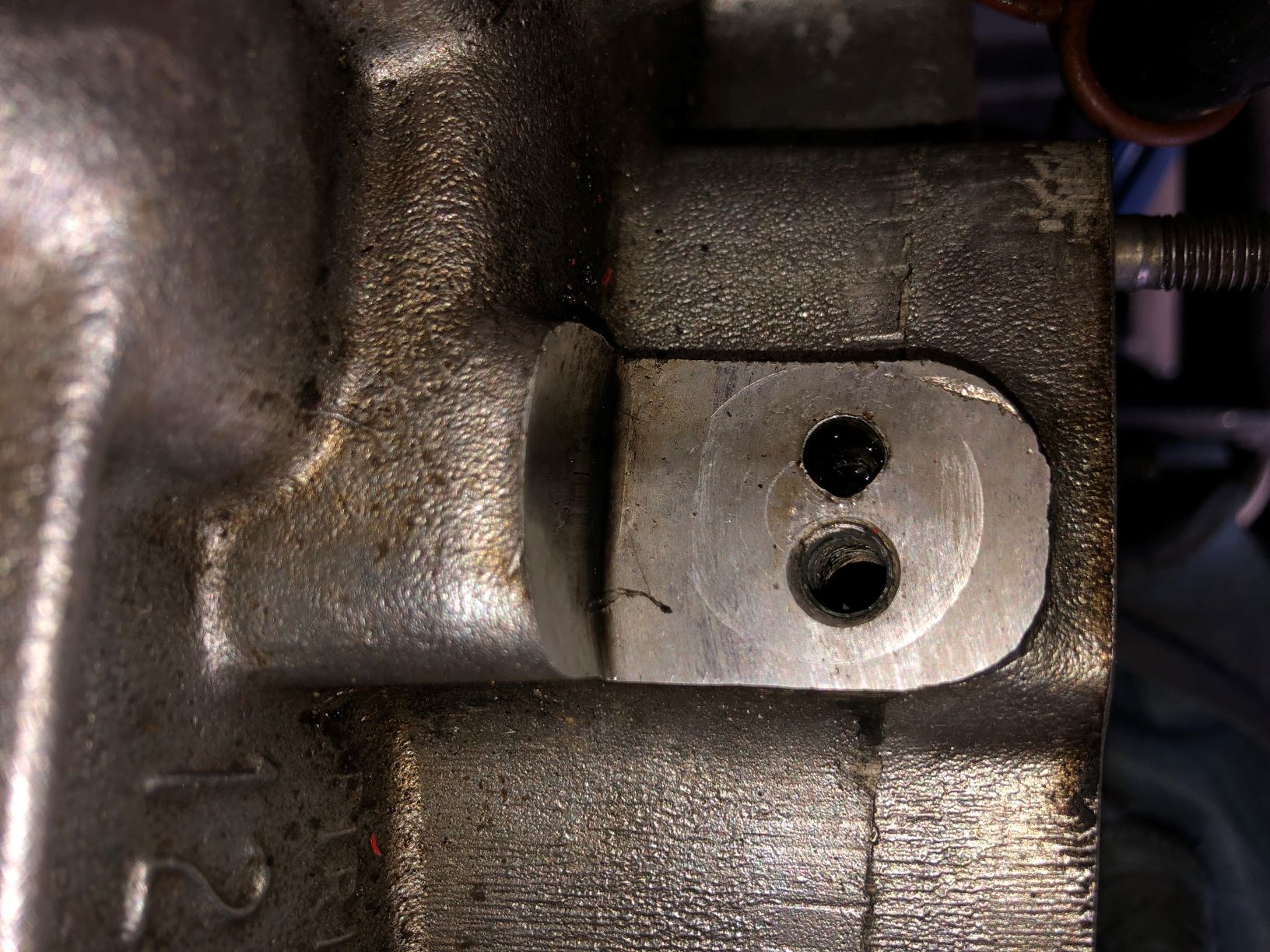

The vacuum source is under the carby, just above the smaller hole, look in the first pho below. Mine had that choke operator removed and a dirty Holley on it, they'd jammed a lead ball into the hole, you can see the ball where I removed it in the first photo, sitting on the carby mount face. The larger hole is threaded, a bolt holds the choke operator on. Just remove the choke operator and plug the hole with a lead ball or even a bit of Araldite or similar epoxy.
